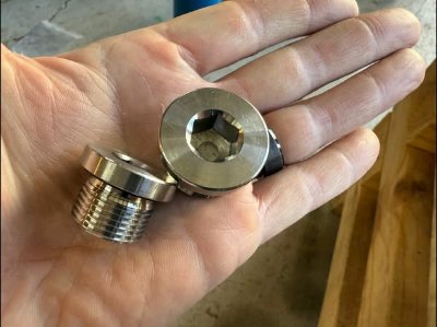

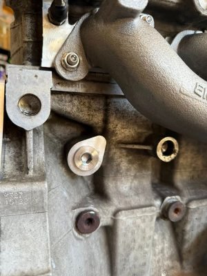

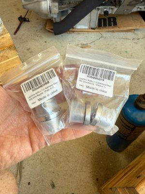

A good bit of info ends up in the chats so I wanted to post here in case someone else is also looking. The heater core outlets on the motor are M24x1.50 and M20x1.50. I won’t have heat going for awhile on the car yet so I picked up a couple plugs on Amazon and all set.
