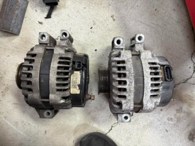

example below is of an early vs late:
early vs late alternator.jpg (30.97 KiB) Viewed 505 times
