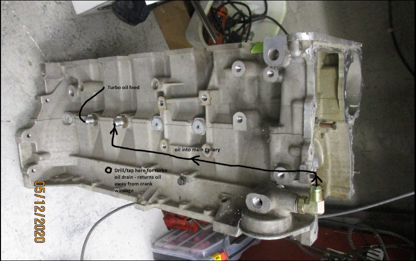

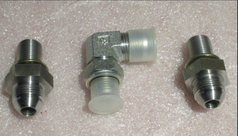

These fittings allow full oil flow to the #2-7 main bearing and ALL the rod bearings.
They use -8 oil lines and the main gallery fittings are custom made from 4140 hex bar. The tapered side of the gallery fittings are drilled to accept a 1/8 NPT tap, so you can install a 1/8 NPT fitting to feed a turbo.
