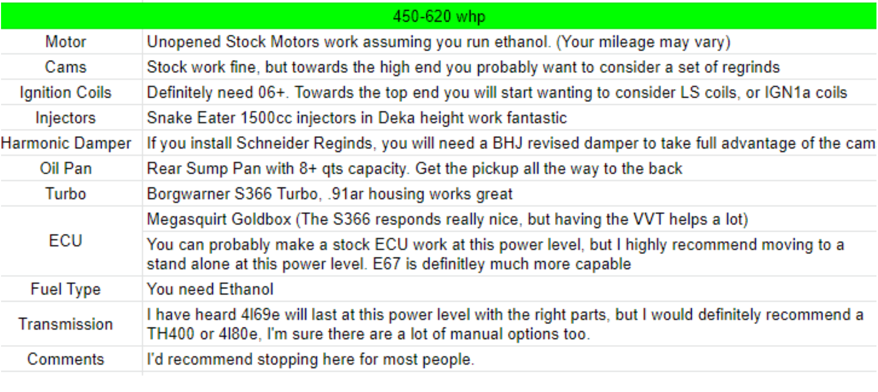

SIMPLIFIED POWER MATRIX
All Q&A for the 4200 SERIES
Info provided by Calvin of Nivlac57 Youtube Channel
1 BMP.bmp (3.56 MiB) Viewed 619 times

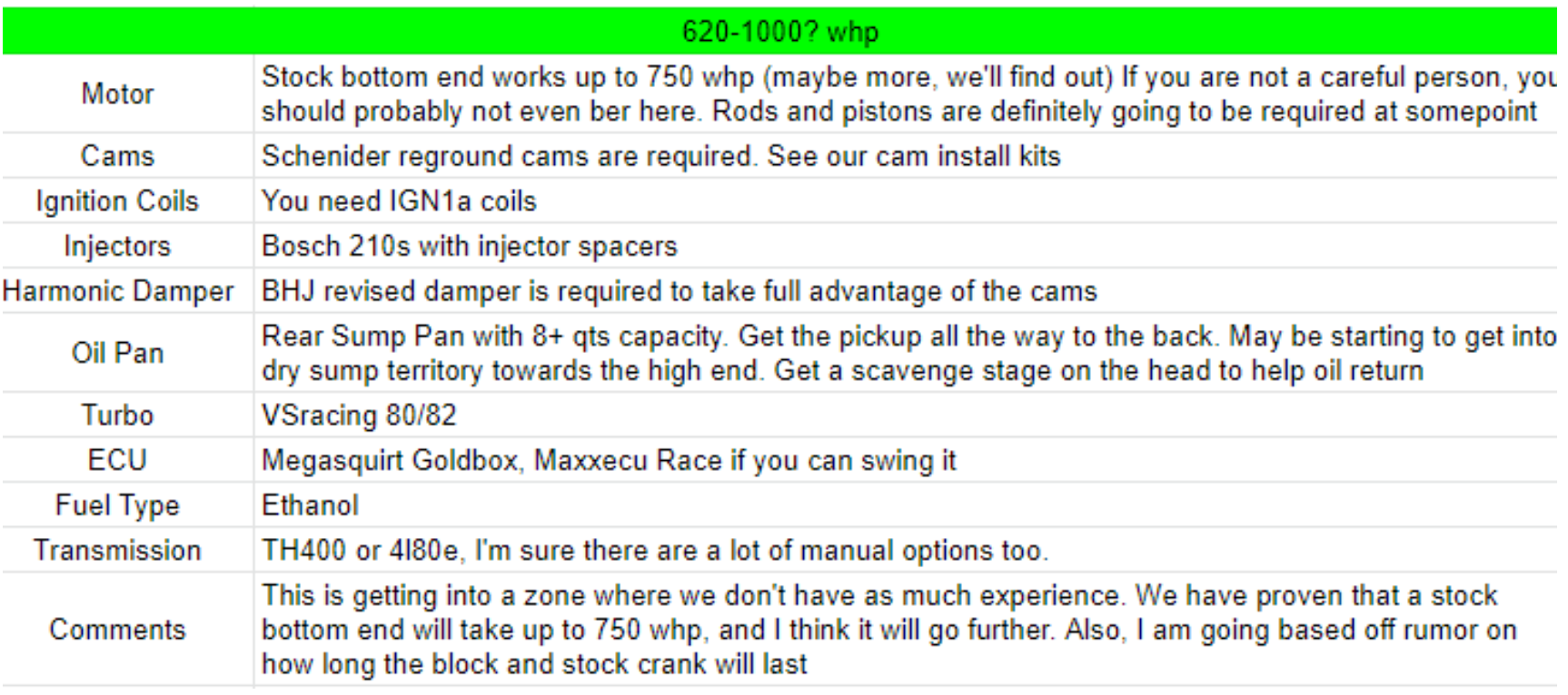

2 BMP.bmp (4 MiB) Viewed 619 times

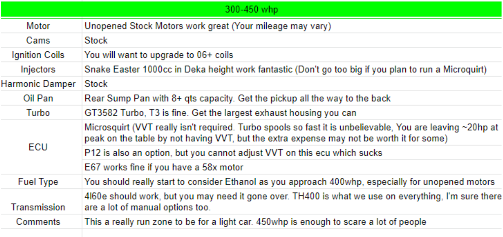

3 BMP.bmp (3.77 MiB) Viewed 619 times
