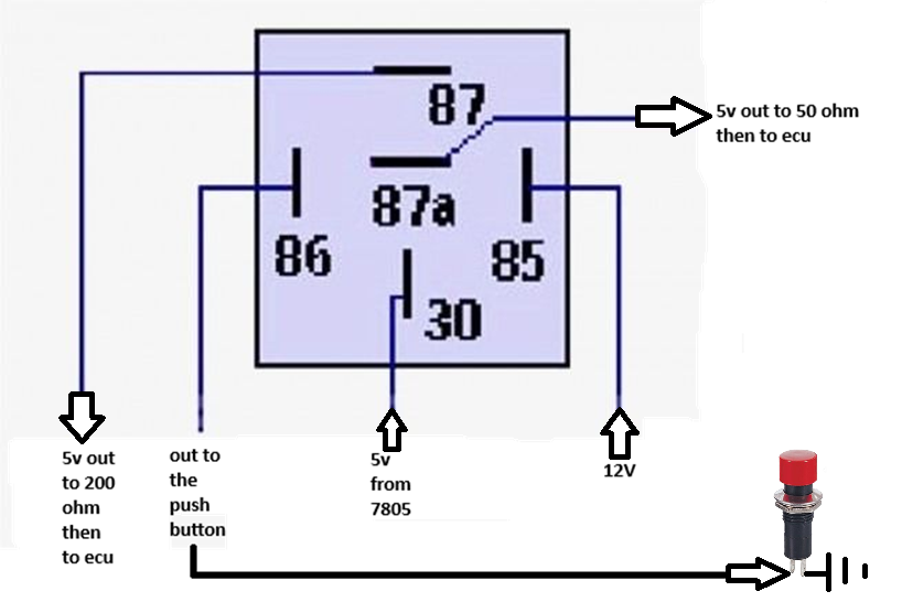

So how this will work out in text form is that:
-12V goes to 85 or 86, dont matter which one, just know that if you choose 85, then pin 86 will go to the push button, or if you choose 86 to put 12v to, then pin 85 will go to push button.
-which ever push button you use, will take the ground side of the relay coil (not the 12v), and then out of the other side it will go to ground.

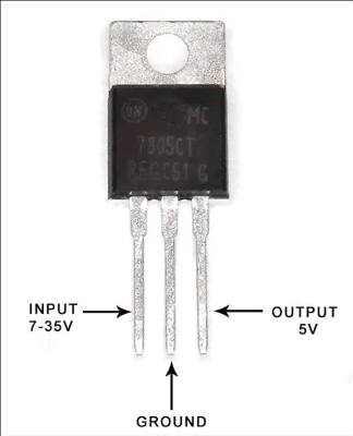

-Now, this is where the LM7805 comes in at. It has 3 legs as youll see in the image. It will take "IN" 7-35 volts. middle leg is Grounded. And the right leg will give you a steady 5 volts "OUT". This will make things so much easier to drop the voltage to whats needed for the ecu to see. So the same 12V that you fed the relay with will also just jump over (you can solder it to the relay pin if you feel like it) so that you feed the 7805 with 12v. Ground it! Then the 5 Volts out of the 7805 will go to PIN 30 on your 5 pin relay.
-pin 87A will then put out 5v, this will need to go though a small 50ohm resistor (to be adjusted later if determined current draw is different) and then to the ecu. After the resistor you should be seeing 4 ish volts.
-pin 87 will only become active when you push the pushbutton, which then grounds the relay and makes it change states. This is when pin 87 will have 5 volts on it. AND ONLY WHILE YOU ARE PUSHING THE PUSH BUTTON!. That 5 volts then goes to a 200 ohm resistor to drop down to 1 volt. this then goes to the ecu.
