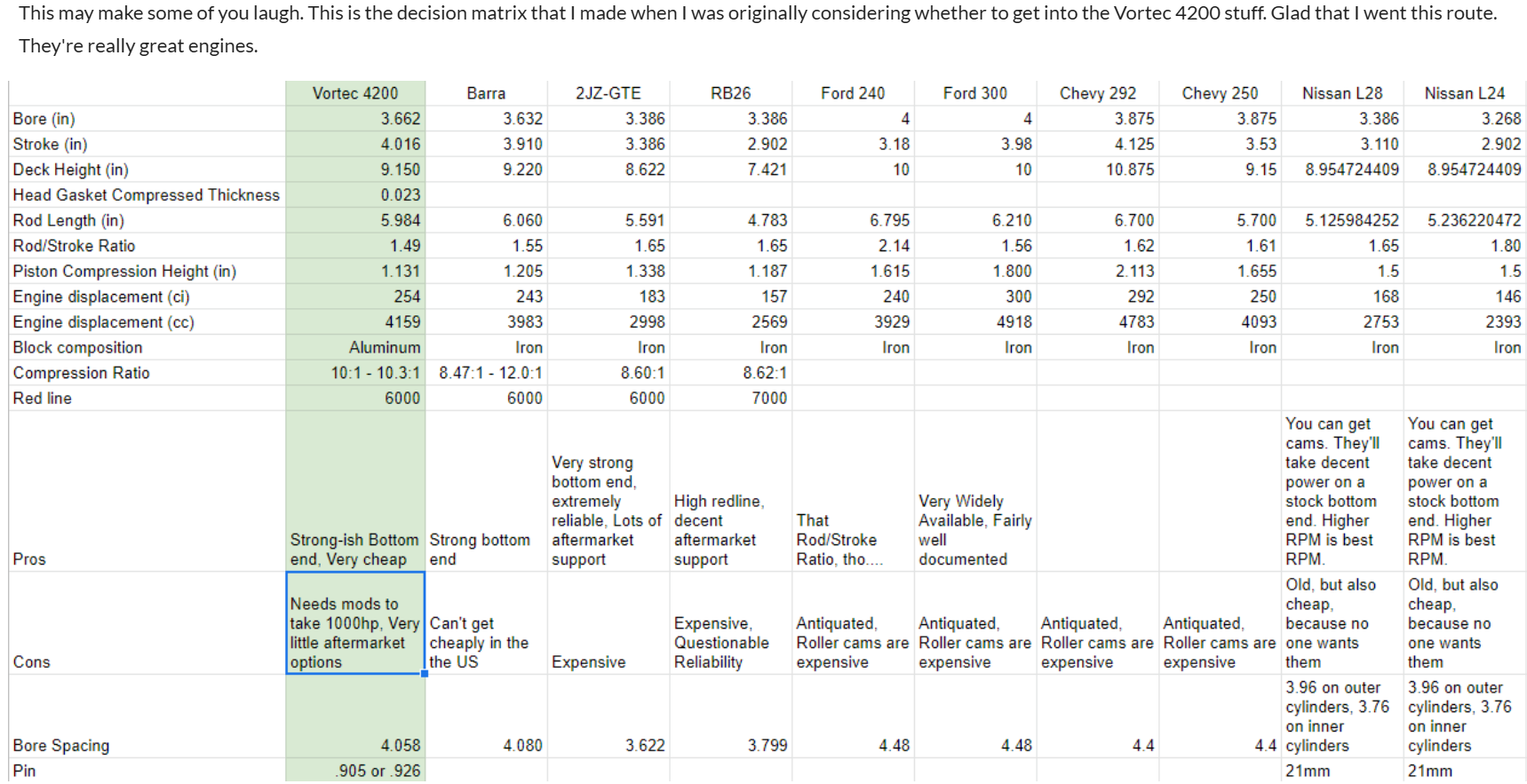

This may make some of you laugh. This is the decision matrix that I made when I was originally considering whether to get into the Vortec 4200 stuff. Glad that I went this route. They're really great engines.

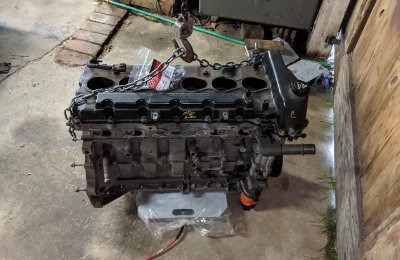

Weight is a Dimension too...
320LB FOR A BARE LONG BLICK. NOT BAD NOT BAD....

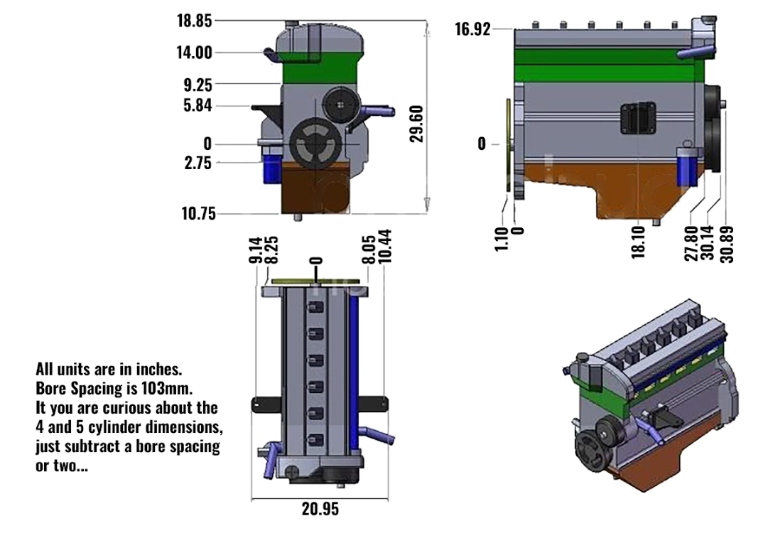

SCALE WITH ENGINE ON IT

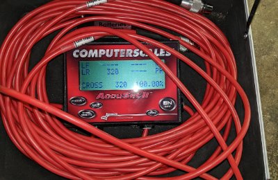

4200 ON A SCALE
4200 ON A SCALE
