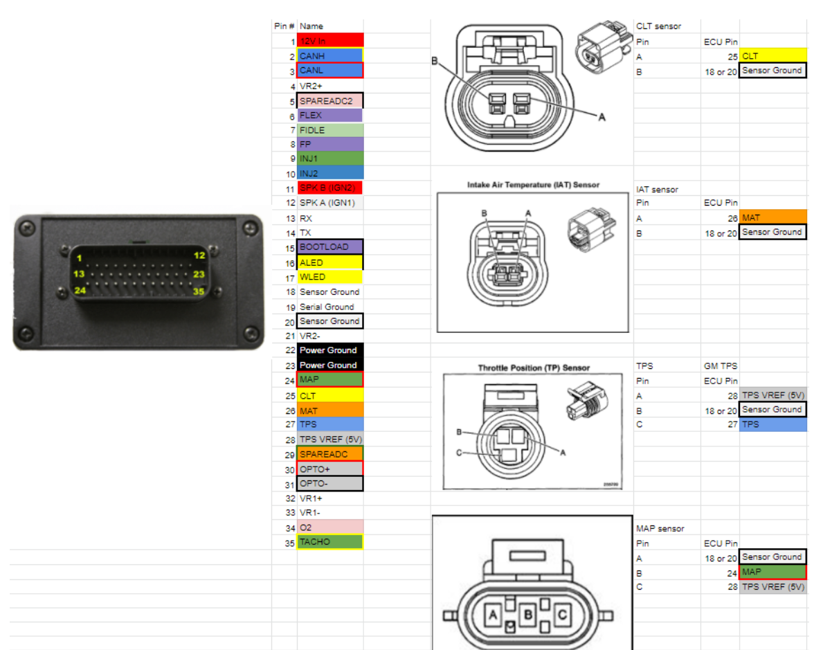

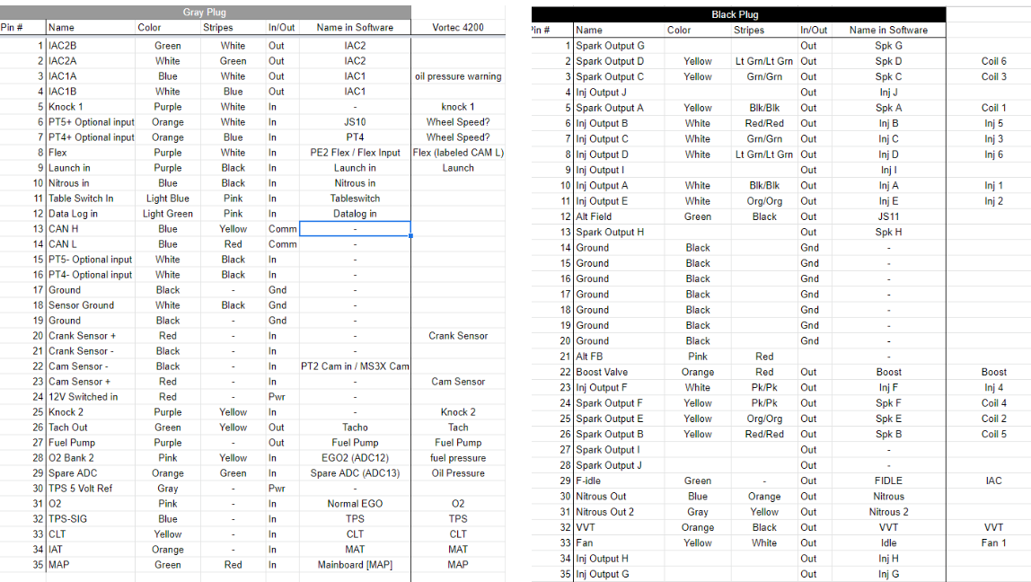

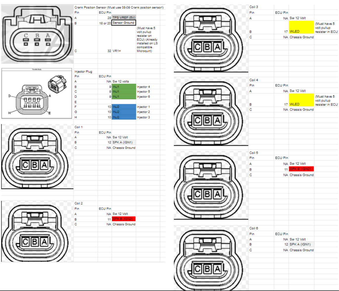

In performance applications, I strongly recommend people go to an aftermarket ECU. Microsquirt is a very cheap entry level option that is very simple to wire. Tuning can be a little difficult with this ECU, and I generally recommend people stay away from super large injectors with a Microsquirt. Running a Microsquirt will require a switch to a cable driven throttle body. Here is a complete wiring guide to making your own harness. Please note that you must run a 08-09 crank position sensor with any aftermarket ECU, because the older VR sensors don't work well with aftermarket ECUs.
pinout 1 bmp.bmp (3.16 MiB) Viewed 468 times
pinout 2 bmp.bmp (3.32 MiB) Viewed 468 times
pinout 3 bmp.bmp (1.15 MiB) Viewed 468 times
